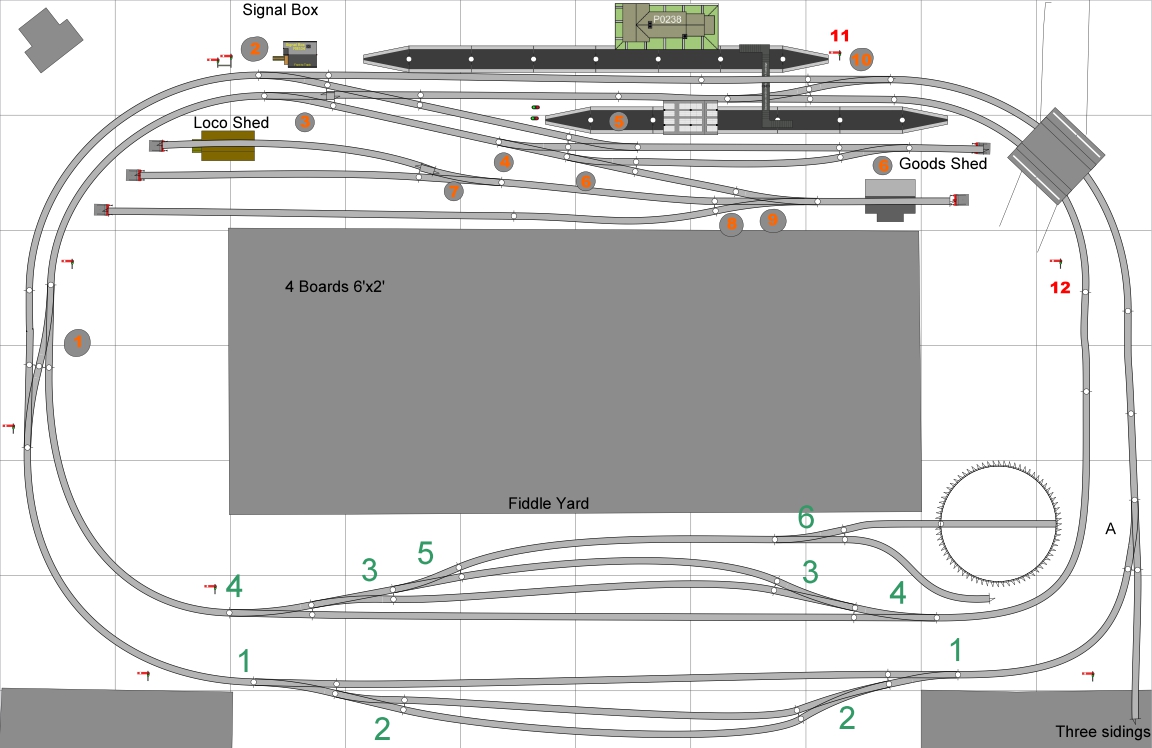

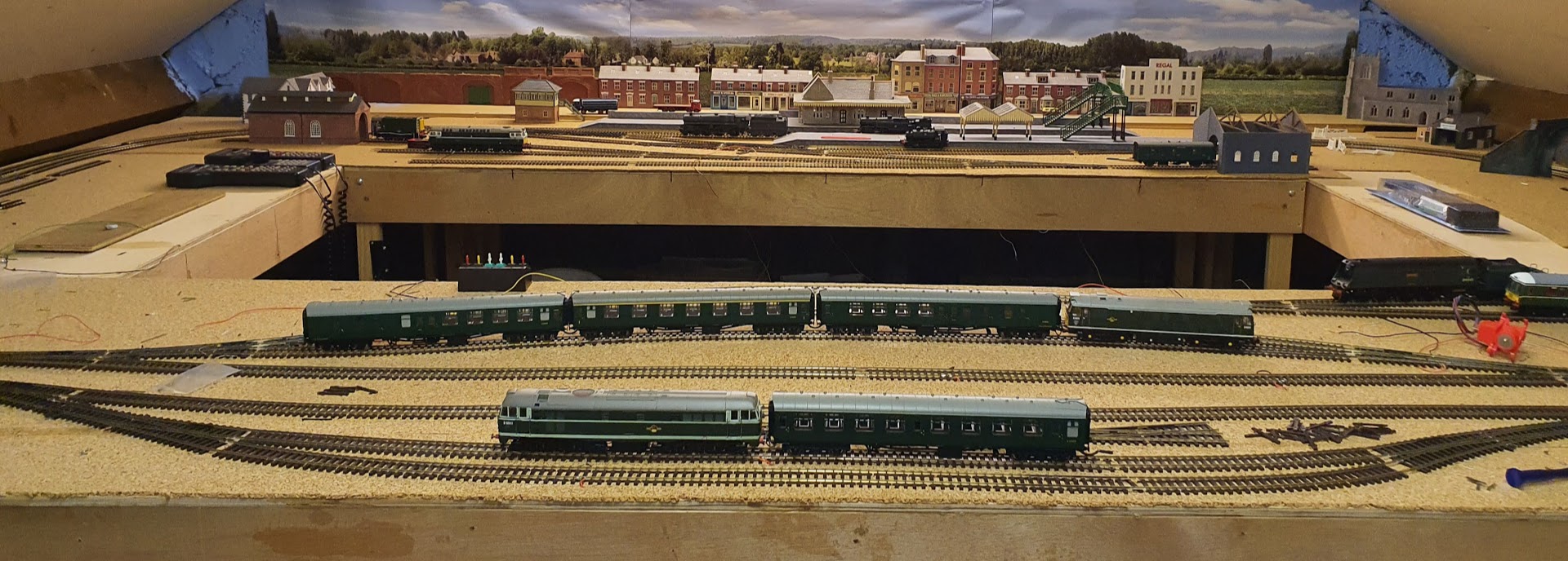

BUT I have purchased four professionally made base boards (Model Railway Solutions) each 6' by 2' to make a layout 10' by 6' which is more compact and takes up less room in the loft.
The layout plan is here:-

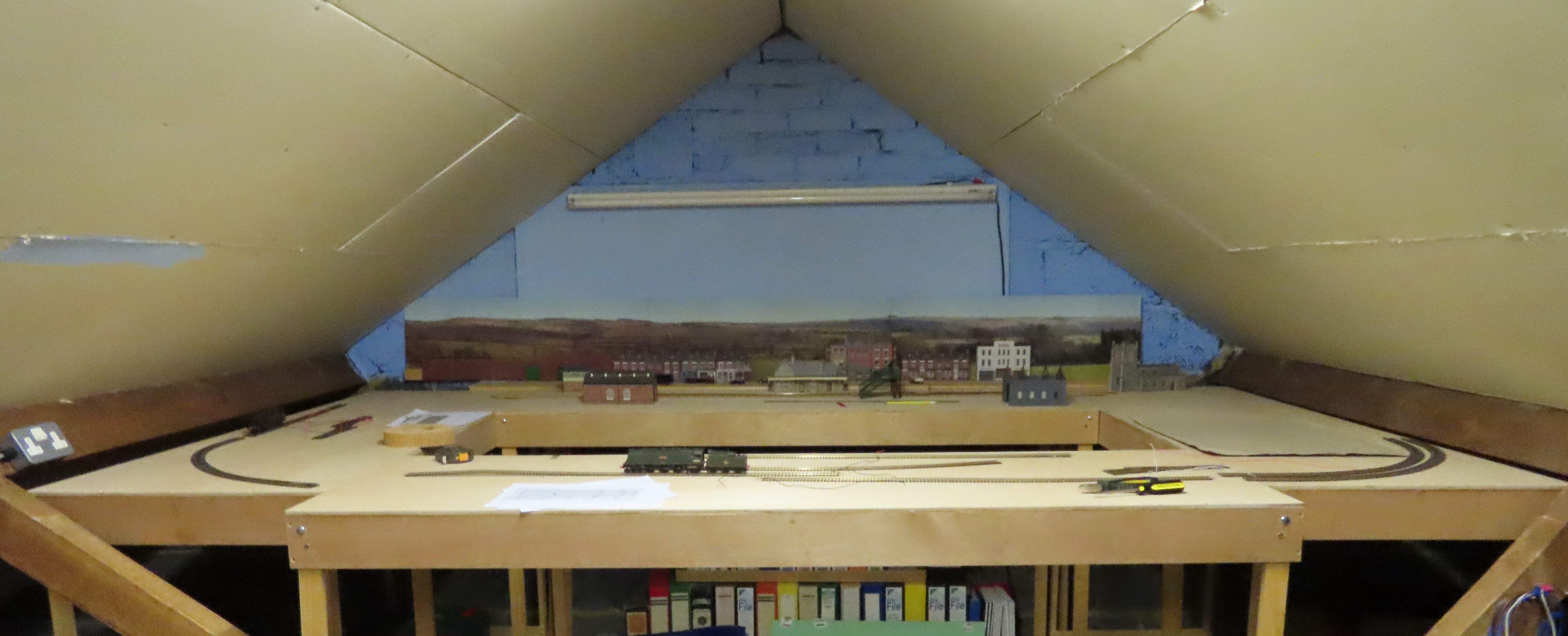

The new baseboards are now in position:-
Base
I have finished laying all the cork underlay and can soon start on track laying - 25 Sept 2020.

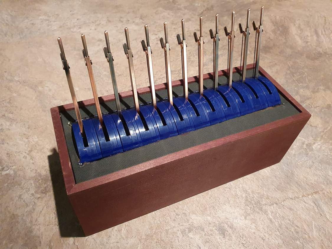

Levers
AHModelRailway14
AHModelRailway3

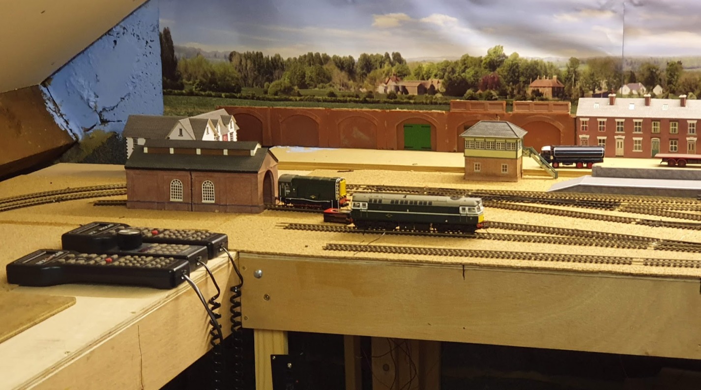

Making progress with scenics now that all electrics are complete and working.  Not very good at ballasting and there is a lot to do! July 2022. Hot in the loft so overall progress is very slow.

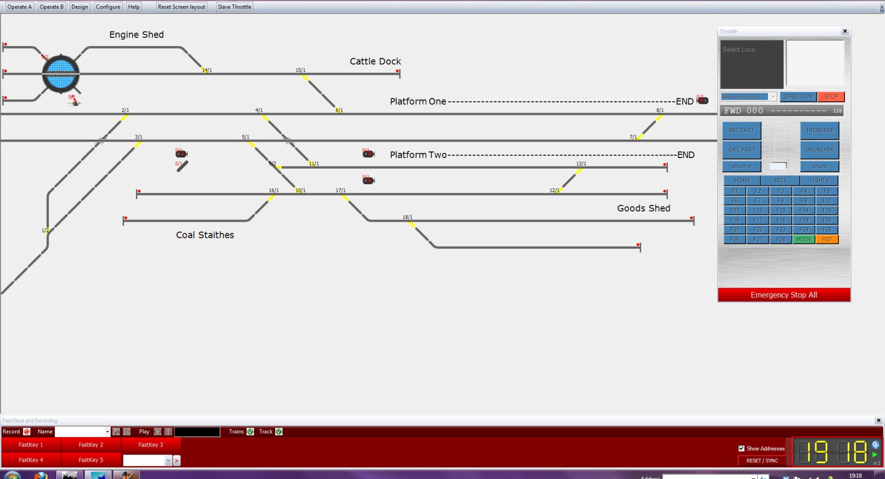

I have decided now to replace all my Gaugemaster systems with the NCE Powercab System. I have also decided to use the Big Bear software for computer control of the railway. Below is the control diagram on the laptop computer that will eventually control the railway (Manual control will also be available). The diagram covers the main staion area, the goods yard and the engine shed and turntable. The fiddle yard on the other side of the railway will remain under manual control.

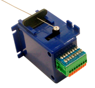

I am gradually replacing many of the Peco solenoid point motors with these Cobalt motors. They are superior in nearly every respect and are ideally suited to DCC and also Computer Control. They also have two inbuilt SPDT switches for frog power switching, indicator panels or signals.

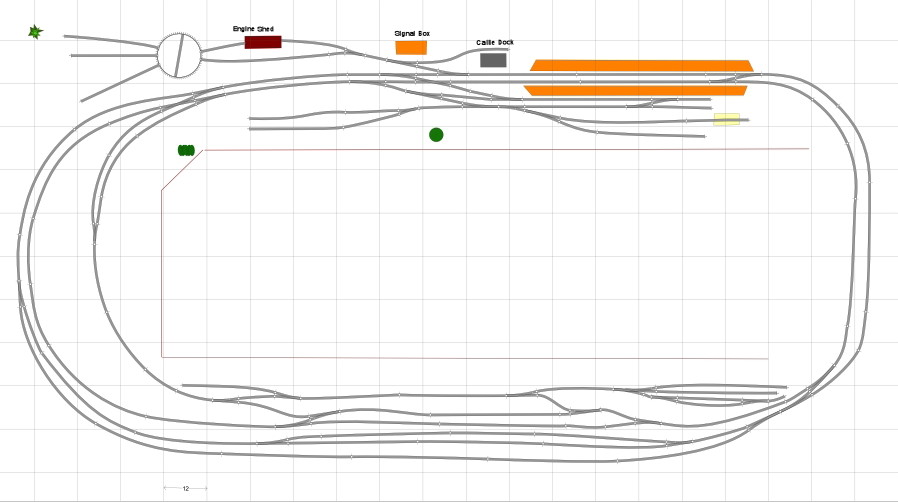

MRPlan
LayoutDiagram

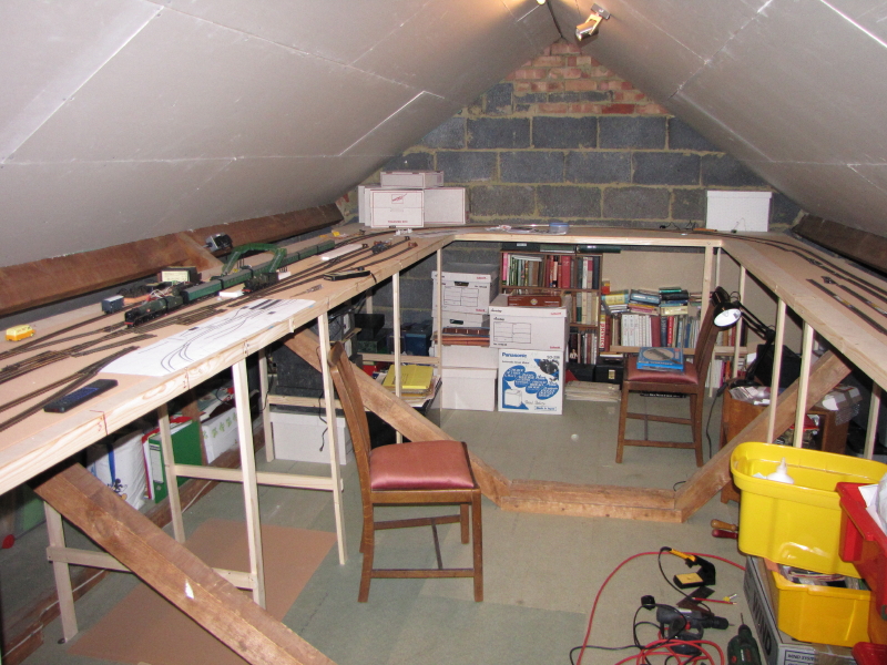

The space allows me a layout 20' x 10' around the edge of the loft at about waist height. This is the basic layout plan. I wanted
to have a continuous run with up and down main lines but also a branch line, goods yard and engines shed!
In other words - the lot!
The main boards are 30" wide and the fiddle yard boards 18" wide. Height is 42" 6mm board made up with 2" x 1" frames and
all mounted on a 2" x 1" H legs. I already had a few locos, carriages and trucks so

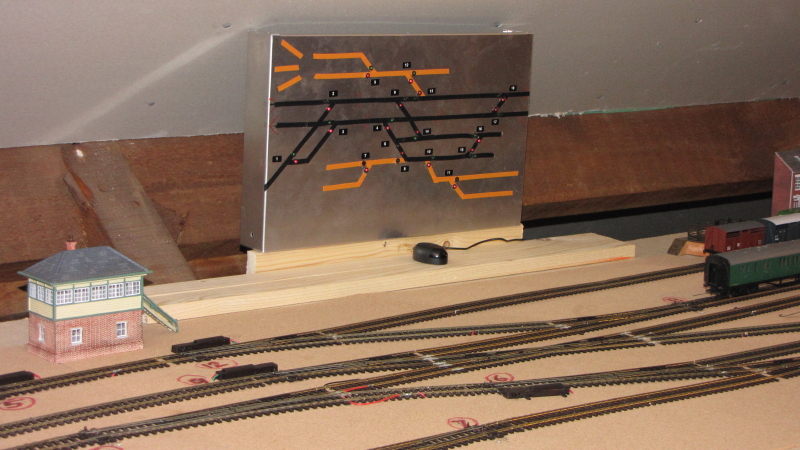

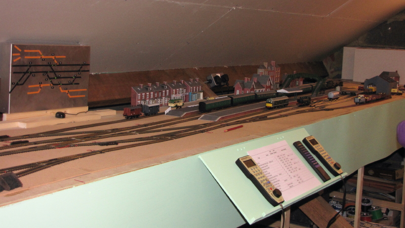

panel
I also decided to use Micro Miniatures http://www.microminiatures.co.uk/acatalog/IR_Points_Motor_Controller.html
infra red point controller. Again this seemed like a good idea at the time but now I discover that it cannot control Tortoise
or Cobalt point motors. I have made up a display panel which shows the position of every point on the  main layout.
Normal point position is shown by a green led and change position by a red led. Routes can also be set with this system.
desk

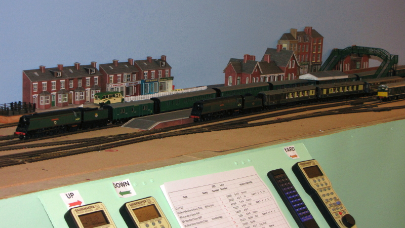

After investigating the various DCC Control systems available I decided on the Gaugemaster Prodigy Advance 2 system.
I now have three walkabout controllers and it is also connected to the Gaugemaster software on and old laptop computer.
I have built a small desk on which to place the controllers along with a spreadsheet showing all the loco numbers and routes.

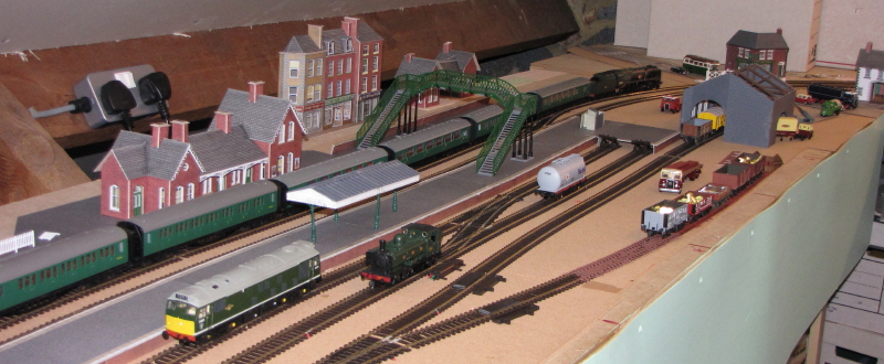

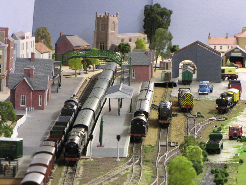

The station area is coming on. The 2 aspect coloured light signals are working but the fine details (ladders etc.) will be added later.
My son Gareth bought me some Traintronics two aspect signals for my birthday.

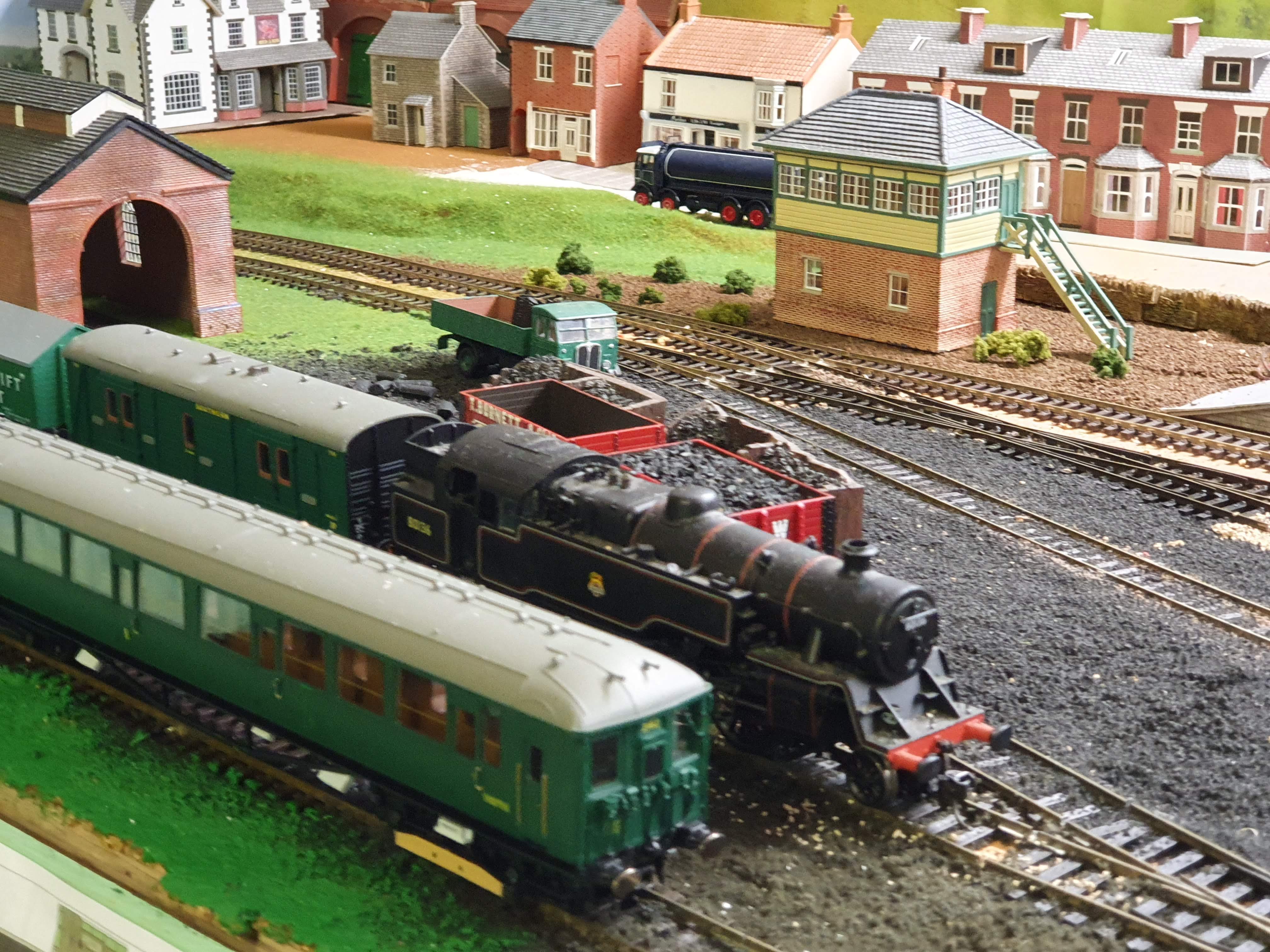

coal 2
Coal Yard closeup.

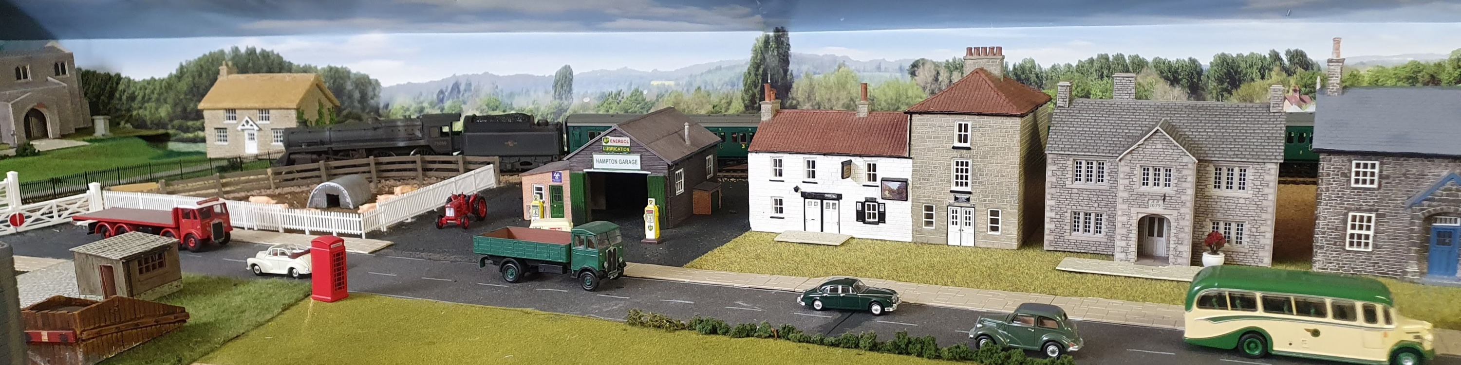

I have a lot of work to do on the roads. Also the many buildings need chimney pots and the cinema has to be finished!
I have working lights for roads and the station but they are waiting installation. Platform signs and posters are also needed.
town
The Goods Shed needs its roof, doors and finishing.

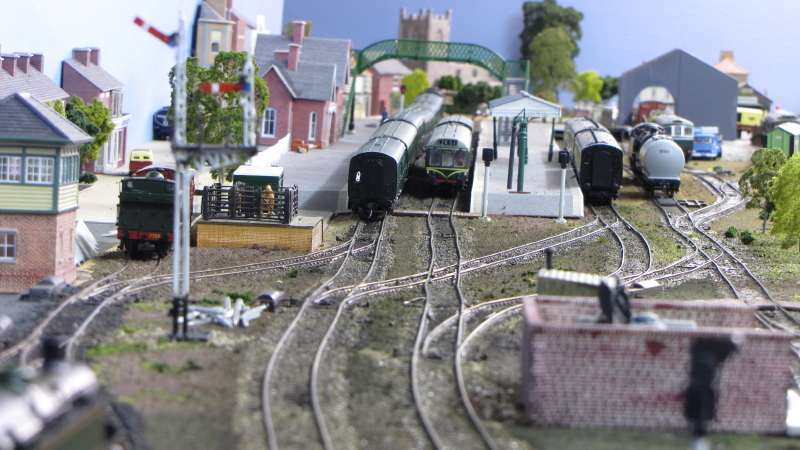

I ordered a SR branch signal from Stephen Freeman. The layout now has a mixture of semaphore signals and coloured light (two aspect) signals.
They are all connected up through Heathcote Electronics IRDOT infrared train detectors and IRDASC circuit boards.
Each of these in turn connects to the previous signal.  The signals turn to danger after a train has passed and back to green when
the train has cleared the next section. The coloured light signals work  directly off the detector boards while the semaphore
signals need the servo control boards to operate the signal arms.
All this means that whoever is driving a train has to obey the signals or collisions might occur!!

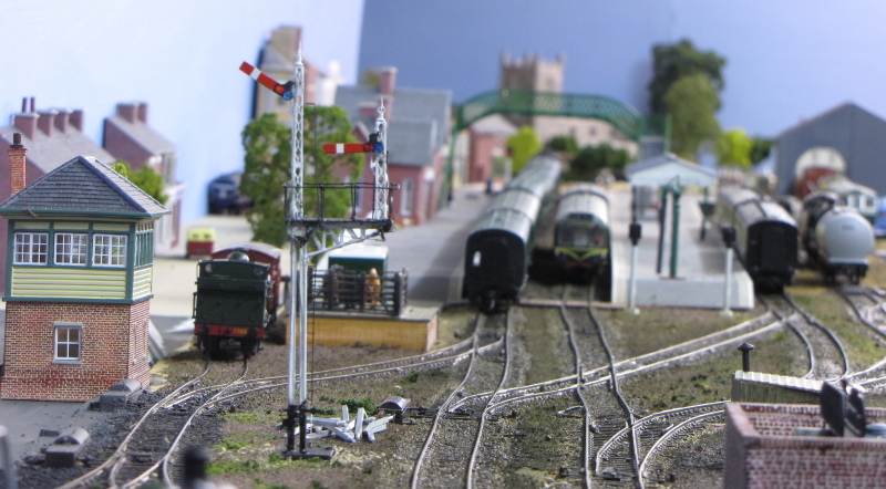

signal 1
The new signal is now in position.
signal 2
A better view of the new signal made for me by Stephen Freeman of  Borg Rail. It is fully working with lights and servos
but they are not yet connected.

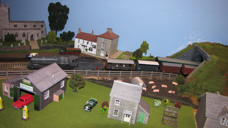

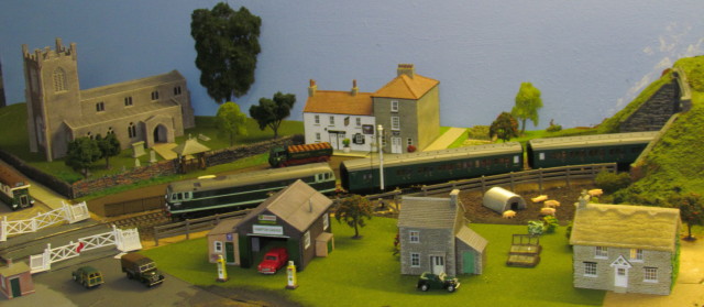

The church and tunnel at the other end of the layout. Much work still to do here. The temporary LED signal lights
 are to be replaced with a working semphore signal. This is in the workshop being finished at the moment.
church

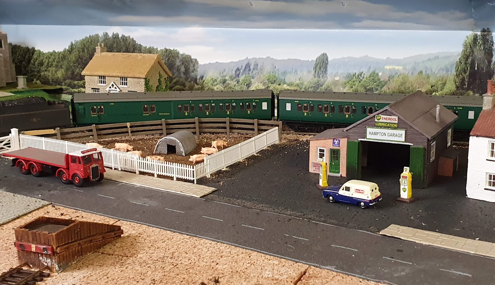

Lytch Gate still come for the church. Level crossing and roads to be finished.
view
Gardens, driveways etc. to be finished. Pathways to be layed.

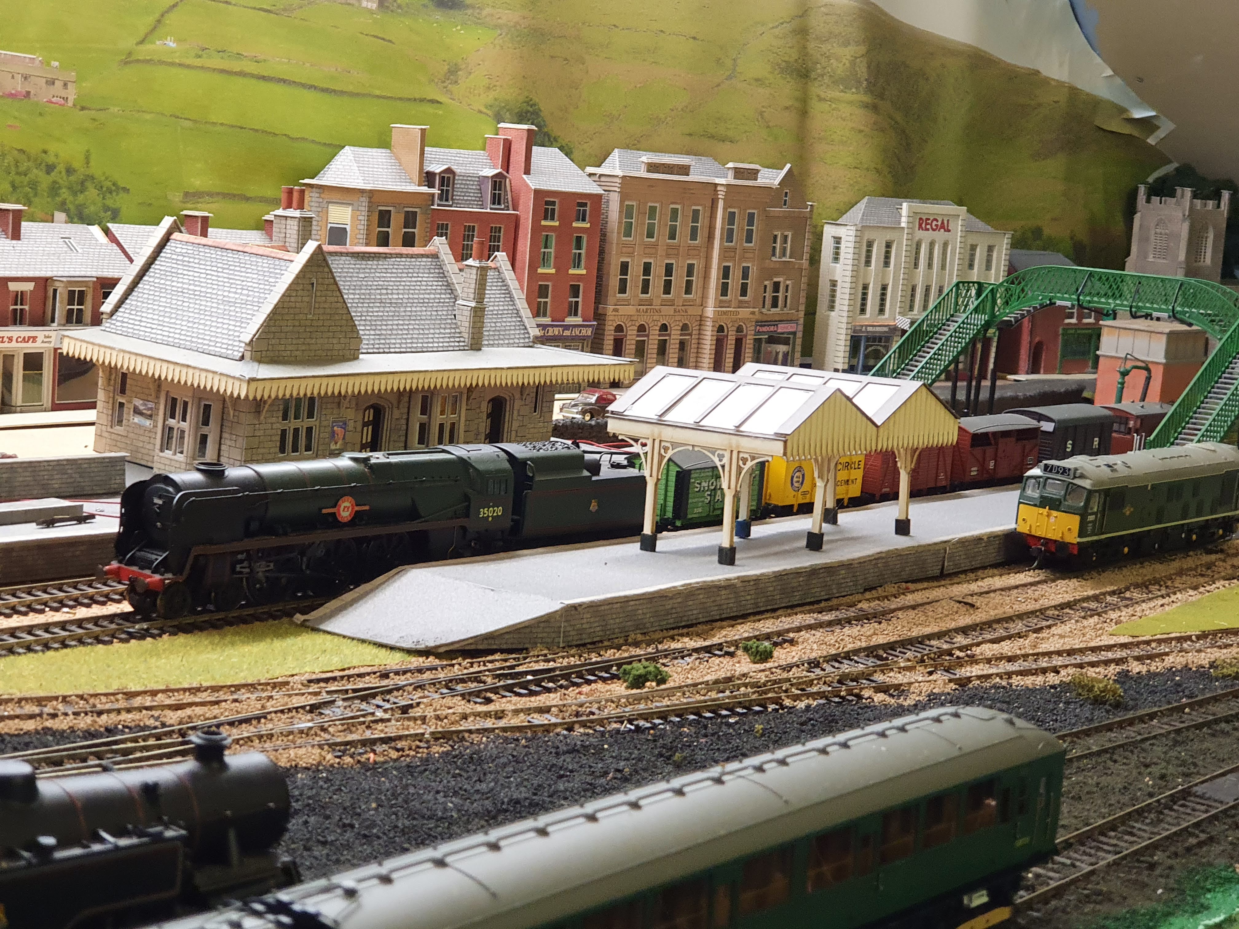

station1
A Station Platform view.

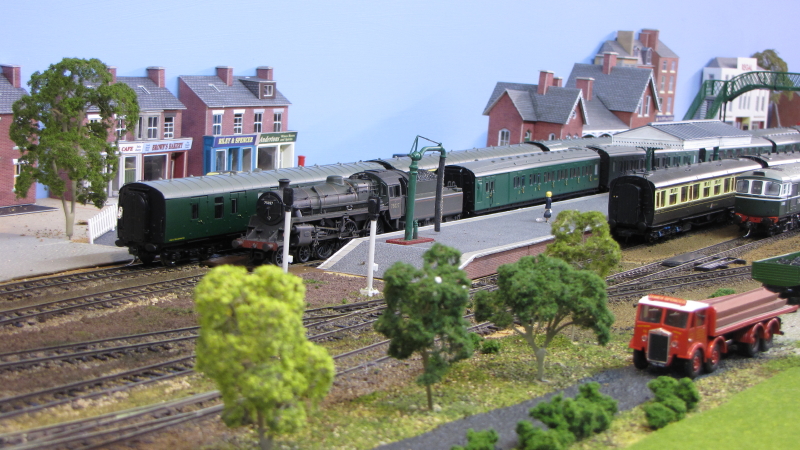

Station2
A goods train passing through the station. Cinema still to be finished.
